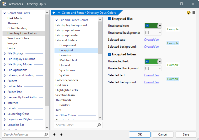

This page lets you configure the colors of everything that isn't a Windows control.
The various color categories are arranged in two main groups:
  • File and Folder Colors: These are the colors 1) that are used for the display of files and folders in the File Displays, and elements related to them.
  • Other Colors: These are colors used elsewhere in the user interface - they're not related to file displays themselves, but to other parts of the Lister.
At the bottom of the color list is a search field that lets you search the color list.
Selecting a category from the color list displays its associated colors on the right. Some colors also display a preview of how it will look in real life - useful when you're picking both text and background colors and want to check for readability.
Note that when you edit colors on this page you're only editing the colors in the current set ("dark" or "light") - use the options on the Themes page to select which color set is in use.

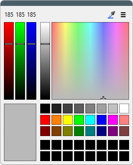

The color picker button is the main control for editing colors. Some color pickers have a checkbox on them, which lets the associated color be enabled or disabled. Clicking the button displays the color picker.
The color picker lets you choose a color using both the red/green/blue and hue/saturation/luminance models. The current color values are shown at the top-left of the picker - you can click there to type new values in directly. If the color in question supports transparency, an additional slider lets you set the alpha value from 0 (fully transparent) to 255 (fully opaque).
The eyedropper icon can be dragged out to pick a color from somewhere else on your screen.
The 16 squares at the bottom let you save your own favorite colors - right-click on a slot to store the current color, or left-click to load a saved color in.
The button shows a menu containing several commands:
  • Copy: Copies the value of the current color to the clipboard.
  • Copy with alpha: (Only for colors supporting transparency.) Copies the current color value to the clipboard, including the alpha channel (transparency).
  • Copy markup code: Copies the current color as markup code that you can use in various places in Opus that support HTML (e.g. in file type infotips.)
  • Paste: Paste a color value from the clipboard into the picker. If the color supports transparency, but the clipboard doesn't include that information, the clipboard's RGB values will be used and the existing alpha value will be kept.
  • Paste (swap with clipboard): Paste a color value into the picker, and put the previous value on the clipboard.
  • Reset to factory default: Resets the color to the factory defaults.
  • Reset to initial value: Resets the color to the value it had when the Preferences dialog opened.
  • Reset to last saved value: Resets to the color value that was last saved to your configuration.
  • Get other mode color: Lets you pull in the color from the other color set (e.g. if you're in dark mode, you can pull in the color from the light mode color set).
  • Use hex format: The color value displayed at the top-right, or copied to the clipboard, will be in hex format (#RRGGBB) rather than decimal format (RRR,GGG,BBB).
Some of these commands may be disabled depending on the current color value (e.g. if it's the same as the initial or factory default, the reset commands will be disabled).
The commands in that menu are also available when you right-click the color picker button itself (so for example, you don't need to show the color picker in order to copy the color to the clipboard).
  • File display background: The background color of the file display area. You can also set a different color that's used when a file display is in destination mode (either in a single file display Lister or as part of a dual display Lister), also when it's off (i.e. a single file display Lister that isn't either the source or destination). You can also set separate colors for when the quick filter is active.
    If you turn off the destination or background colors, the main background color will be used for both source and destination file displays (and similarly, if the 'filtered' colors are turned off the main colors will be used instead).
    The Inline Sub-folders color is used in the icon view modes (e.g. thumbnails) when sub-folders are expanded. The different background color makes it easier to distinguish the contents of sub-folders from those of the parent folder. The Per-level fade option controls how much the selected color is faded for each subsequent nesting level.
  • File group column: When the file display is grouped, you have the option of showing the group names as headings between each group or in a column on the side. If you choose to use the group column, this defines its colors.
  • File group header: When the file display is grouped, and you opt for group names to be displayed as headings between each group, this defines the text and separator color for the group headings. The glyph colors are used for the icons you click to expand or collapse a group, in display modes which allow collapsing, with the "hot" color used when the mouse is over the glyph.
  • Files and folders: The text and background colors for files and folders that don't derive a color from some other setting 2). You can specify colors for when these items are selected as well as in their unselected state. Using visual styles to draw items and selection boxes may override some of these colors; if this is happening, a clickable message will appear below the last color, and clicking it will take you to the option you can turn off if you don't want this to happen.
    The Current sort column option lets you specify different colors to be used in details and Power modes. The column the list is currently sorted by will be displayed in the specified colors.
    • Compressed, Encrypted and System: Optional colors for various types of files that will override the defaults if activated. Compressed files are those with the C attribute, encrypted files are those with the E attribute, and system files are those with both the H and S attributes set.
