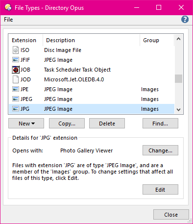

The main File Types dialog displays a list of all registered file extensions, their description, and the group they are assigned to if any. In the above screenshot you can see that .JPE, .JPEG and .JPG are all part of the JPEG Image file type, and are also assigned to the Images group. You can change the group that a file type is assigned to by moving the mouse over the Group column - a drop-down control will appear that lets you pick the group.
The New drop-down is used to create a new file type or group. The Copy button lets you duplicate an existing file type, and the Delete button lets you delete it.
You can locate file types using the Find function, which lets you search by extension, descriptions and other properties. You can also quickly jump to a file extension by activating the file type list and typing the extension in.
The area at the bottom of the dialog displays information for the currently selected file type including its "default handler" (Opens with: Directory Opus Viewer in the above screenshot). The default handler is the program that will (normally) be used to open the file when it's double-clicked - you can change this by right-clicking a file and using the Open With menu, similar to what you'd do in File Explorer.

Use the Edit button at the bottom of the dialog to display the File Type Editor for the currently selected file type.
