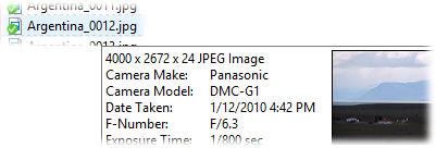

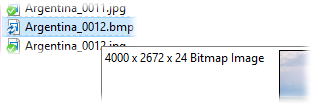

The info tip definition (the image above illustrates the default info tip for the Images group) uses various {..} codes to insert information about the file into the info tip. Each line in the edit field corresponds to a line in the info tip. If a line in the definition uses a code that isn't valid for the specified file (for example, a .bmp file doesn't support EXIF metadata in it, and so fields like {cameramake} would be empty), the whole line is omitted from the info tip. You can have multiple codes on the one line and in that case, the line is only omitted if all codes on the line are empty.
You can see that for the .jpg file in the above screenshot, all the EXIF information defined in the info tip is shown, but the info tip for the .bmp file simply displays the top line ({desc} produces the 800 x 599 x 24 Bitmap Image description and {thumbnail} displays the image's thumbnail).
