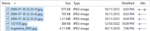

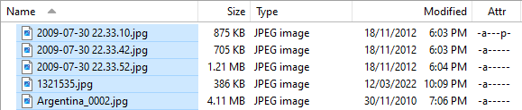

  • Filename only: Only the filename is active - clicking anywhere to the left or right of the filename will not select the item.
  • Full width of the Name column: The entire Name column is active - clicking anywhere to the left or right of that column will not select the item.
  • Full row: The entire row is active - you can click anywhere on the item, in any column, to activate it.
  • Always highlight full row: Normally the option above controls both the active area for selection and the width of the highlight that is displayed for selected items. If this option is on, the full row will be highlighted when an item is selected, irrespective of which option is selected for the active area.
