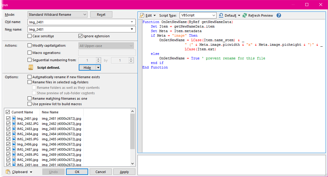

Here's a reasonably simple example of a scripted rename. You can see that the script editor has been shown. This is initially pre-populated with a do-nothing script that you can edit.
The Script Type drop-down at the top is used to specify the scripting language - in the above example, VBScript is selected.
  1. For each file to be renamed, Opus calls the OnGetNewName function.
  2. The parameter passed to the OnGetNewName function is a GetNewNameData object.
  3. From this we obtain the item property, which returns an Item object.
  4. From the Item object we obtain the metadata property, which returns a Metadata object.
  5. We check the default value of this object - if it returns "image" we know the item is an image file.
  6. We build a new name consisting of the original file's name stem (the Item.name_stem property, converted to lowercase by the VBScript LCase function).
  7. We then append a string displaying image's dimensions (extracted from the Meta.image object which provides the picwidth and picheight properties).
  8. Finally the original filename extension (Item.ext) is appended.
  9. The new name is returned from the OnGetNewName function (the convention in VBScript, shown above, is to return a value by assigning it to the name of the function itself).
  10. If the image wasn't an image file we return True which tells Opus to skip over that file without renaming it.
