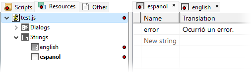

String editor
To add a new string resource language, switch to the Resources tab in the script editor, right-click the script file in question, and choose New Strings from the context menu. Opus will prompt you to select the language you want to add strings for.
The string resource editor is a very simple grid with two columns. The Name column lets you specify a name for the string - in the above example, this was set to "error". The Translation column lets you provide the translation for the selected language.
