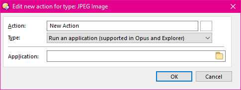

When you add a new context menu item to a system file type, you need to choose whether it is going to be global or Opus-only.
This is accomplished using the Type drop-down. This drop-down initially has four options:
  • Run an application: Defines a context menu command that runs an external program. This will establish the item as global - it will show in the context menu in both Opus and Explorer.
  • DDE command: Defines a command that communicates with an external program using DDE. This will also define the item as global - it will work in both Opus and Explorer.
  • Run an Opus function: This will establish the item as Opus-only. Commands of this type can use Opus internal commands as well as launch external programs. It will only be shown in context menus inside of Opus.
  • Sub-menu: This is a special type (explained below) that lets you create sub-menus in context menus. This is also Opus-only.
Once a function has been defined as Run an application or DDE command, you can't turn it into a Run an Opus function-type item; and vice versa. If you click OK to save the new context menu item, and then select it and click Edit you will see that the Type field has disappeared (in the case of Opus-only functions), or now only contains options for Run an application and DDE commands (for global menu items).
If you add a context menu item to a file type group the first two type options aren't available - as groups only work inside of Opus it's not possible to add global menu items to them.
For all context menu item types, the Action field defines the label that is shown for the command in the context menu. The small box to the right of the Action field lets you specify an icon that's also shown in the context menu to the left of the label. The icon is only displayed when the context menu is opened in Opus - it's not supported by Explorer.
The Application field for a Run an application-type context menu command is where you define the path to the external program and any arguments you are passing it. For example, a command that opens the selected file in Notepad might look like this:
The Application command passes the selected filename to Notepad.exe using the %1control code.

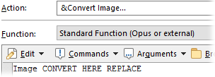

The Run an Opus function type uses a variant of the standard command editor to define a function that can use both Opus internal commands and external programs. You can see an example of this in the context menu for the default Images file type group:
This screenshot shows that a context menu item to invoke the Image Conversion function has been defined for this file type. Because it uses an internal Opus command (Image) this context menu won't appear in Explorer, only in Opus. Actually because this context menu is on the Images file type group it has to be an Opus-only command anyway, but it could also appear on the context menu for a system file type like JPEG Images.
You can see that there is no Type drop-down, as the type of the item can't be changed from Opus-only. The standard command editor controls let you define the function. The label of the context menu item (&Convert Image…) is given in the Action field - the ampersand (&) in the label specifies which letter of the label is to be underlined in the context menu.

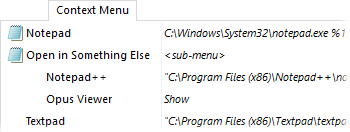

The fourth option in the Type drop-down when creating a new menu item is Sub-menu. This lets you create sub-menus in context menus - you can move groups of commands off the main context menu and into a sub-menu to keep related commands together, or to keep the main context menu tidy. Sub-menus only work when context menus are displayed in Opus - they won't appear in Explorer. If a global context menu item is added to a sub-menu in Opus, it will appear on the main context menu in Explorer.
The only options for Sub-menu are Label and icon (to set the icon click the small box to the right of the Label field).
In the context menu list, items that are in a sub-menu are shown as indented.
In the above screenshot, the Notepad item will appear on the main context-menu, followed by a sub-menu called Open in Something Else. Inside that sub-menu are two items, Notepad++ and Opus Viewer. Following the sub-menu (on the main menu) is another item, Textpad.
All context menu items that appear below a sub-menu in the list will automatically be placed in that sub-menu. To specify the item that marks a return to the top-level menu, you must right-click on it in the list and choose the Decrease Indent command. In the above screenshot, this command was run on the Textpad entry, which decreased its indent level and moved it back to the main menu.
