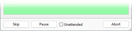

The Unattended checkbox at the bottom of the Copy progress dialog is used to make a copy operation (including any copies in that queue) run non-interactively.
When a copy operation is set to unattended mode, no error or confirmation dialogs are displayed during the copy process. Instead, any errors will be silently logged and you can review these, and retry the failed operations, at the very end of the operation. This lets you start a very long copy job (or queue a whole lot of very long copy jobs), and walk away (or go to bed!) without the risk that you'll come back after several hours to find the queue stalled because of an error or confirmation prompt.

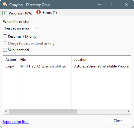

Turning on unattended mode adds the Errors tab to the copy progress dialog, which collects and displays all errors resulting from the operation.

  • Treat as an error: The file will not be copied, and an error will be logged. Logging an error means you can then retry the copy at a later time, and choose how to handle the collision yourself.

Exporting the error list
The Export error list option will appear if any errors occur and this lets you save the list of failed operations to a file (in either text or CSV format).
