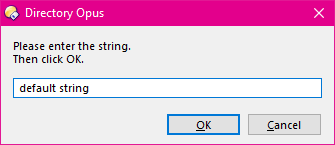

Parameters for {dlgstring}, {dlgstringS} and {dlgpassword}
The template for these codes is {code|<message>|<default>}.
<message> specifies the message displayed in the dialog box, and <default> specifies the default value of the string field.
You can include line-breaks in the message text using the special code \n (and if you need to include a literal \n sequence in the text you must escape the \ character, as in \\).
For example, {dlgstring|Please enter the string.\nThen click OK.|default string}.
