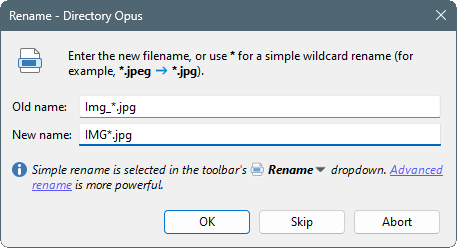

In this example, we want to rename any file that begins with Img_ and ends with .jpg. The match is not case sensitive, so this will match Img_2481.jpg, img_2481.jpg, etc. The * indicates that any text between the prefix and suffix is to be preserved, and the * in the New name field indicates where that text would be placed. Given the following input filenames, the resultant new names would be:
