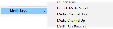

Media keys
When editing a hotkey function (as opposed to a toolbar button's hotkey), the drop-down will also let you select from a sub-menu of Media keys.
These are special input events that aren't associated with the traditional keys on the keyboard. For example, you could use this to assign a function to the Play button on your keyboard, or the Back button on your mouse.
