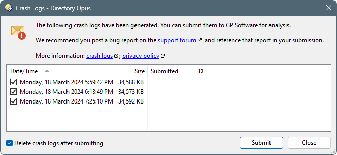

Submitting crash logs
To access the crash submission tool, select the Submit Crash Logs command from the Help menu. You can also run the internal command Help CRASHLOGS.
The Crash Logs dialog shows a list of all crash logs in the temporary folder. To submit them for analysis, simply check them (if they're not checked already) and click the Submit button.
You'll be asked to enter a brief description of what you were doing when the crash occurred - it's ok if you don't know, we can often tell a lot from the log without any additional information. But anything you can tell us will help!
When crash logs are submitted they're given an ID, and if the error that caused the crash is fixed in the future this ID will be referenced in the release notes.
To save disk space, you can choose for crash logs to be automatically deleted once submitted.
