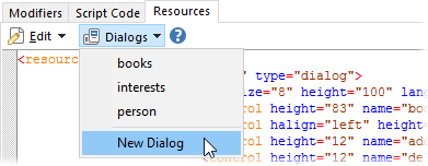

The Resources tab defines any resources available for the script to use. Dialogs are the main type of resource, but also supported are string resources which let you define strings in multiple languages.
While you can hand-code dialog resources in XML if you wish, it’s much easier to design them using the in-built dialog editor.
