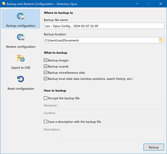

Configuration Compatibility
  • Directory Opus 13 can load configurations, backups and themes saved by Opus 12 and earlier.
  • This doesn't work the other way around! Directory Opus 12 will be confused by new elements in an Opus 13 config.
  • Before installing Opus 13, use Settings > Backup & Restore in Opus 12 to save a config backup, just in case.

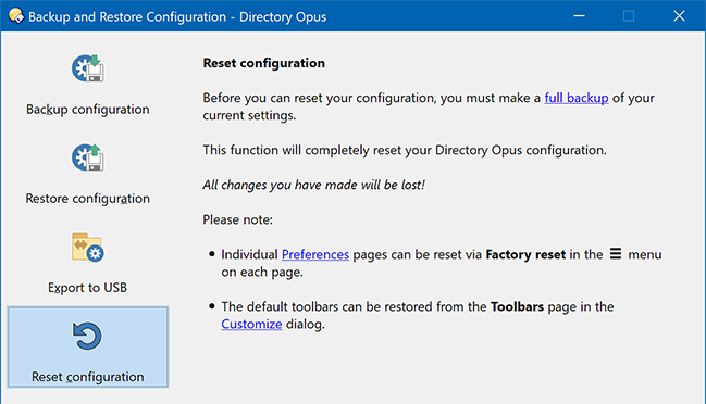

Resetting the Whole Configuration
  • You do not need to reset your configuration! But the option is there if you want a clean slate.
  • In Directory Opus 13, Settings > Backup & Restore includes the option to factory-reset your whole config. It requires you do a config backup first.
  • Uninstalling Opus will also reset your config.

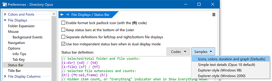

Status Bar
  • Go to Settings > Preferences / File Displays / Status Bar. Click the Samples drop-down on the right. Choose the first option.
  • Use the new defaults, or combine elements of your old and new configs.
  • Important changes:
    • Selection Summaries. (Shows how many files of different types are selected.)
    • Media Durations. (Shows the time length of selected files vs all files in the folder.)
    • The {ls} code won't normally output anything now. See File Copying Between Windows, below.

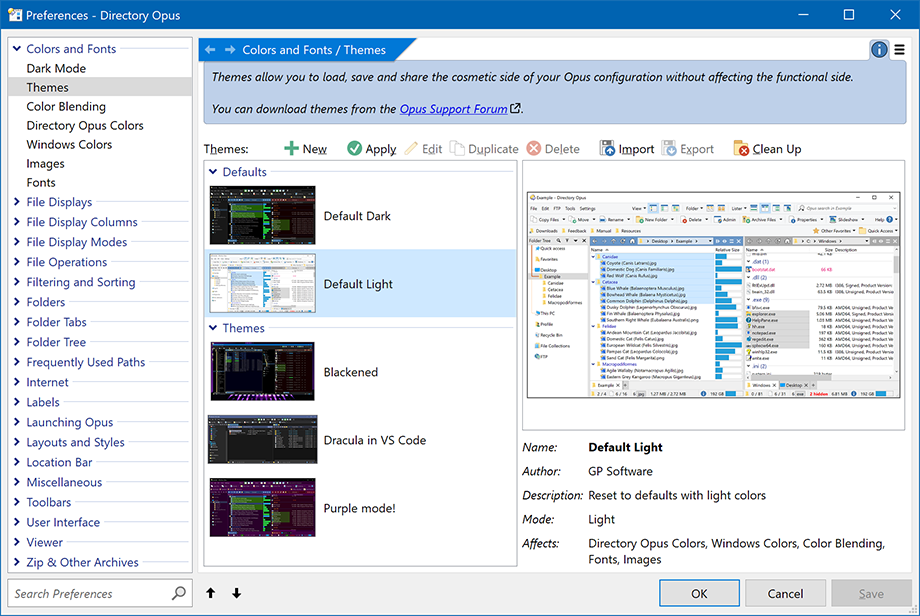

Colors

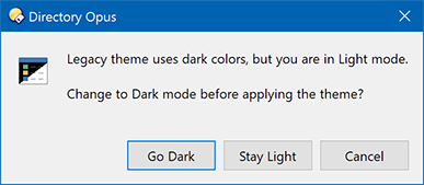

  • When loading old colors and themes, Opus inspects them to determine if they are light or dark.
  • If applicable, it will ask if you want to switch modes.
  • New colors missing from the old data will be filled in from the defaults for the chosen mode.
  • To reset all colors at once, double-click the Default Dark or Default Light themes under Settings > Preferences / Colors and Fonts / Themes.
  • When loading a theme, you're given the option to backup your existing colors first.

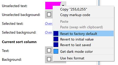

  • Individual colors can be reset via their right-click menu. This also lets you copy colors to the clipboard, or between light and dark modes.
  • The menu in Preferences has further options to reset multiple colors by sub-category or page.

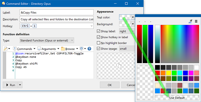

  • If a toolbar or menu has the wrong text color (e.g. black on black), go to Settings > Customize Toolbars and Keys, select the toolbar or context menu in question, and ensure the Label Color override is off.
  • Individual toolbar buttons can also override their colors, and may need fixing in rare cases.

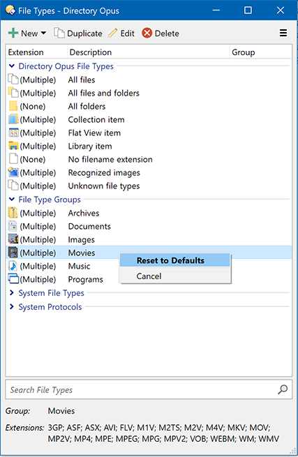

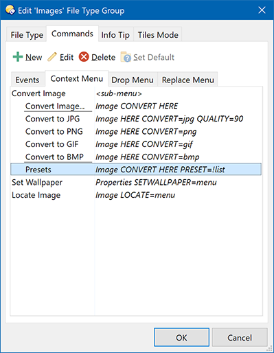

File Type Groups
  • Go to Settings > File Types and right-click each item under File Type Groups. You can reset them there.
  • Of course, do not reset a File Type Group if it has custom changes you want to keep!
  • Reseting a File Type Group affects everything inside it, including…

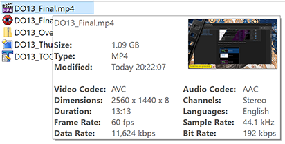

  • Info-Tips. (E.g. New information when you hover over videos.)
  • File context menus. (E.g. Image Converter presets when you right-click images.)
  • Extension lists. (E.g. Updated definitions to classify file types as videos, images or audio.)

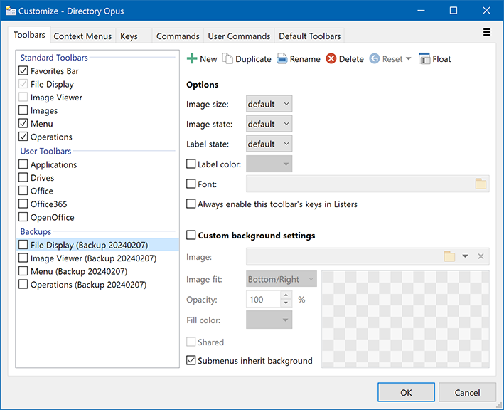

Toolbars, Menus and Hotkeys
  • Edited via Settings > Customize Toolbars and Keys.

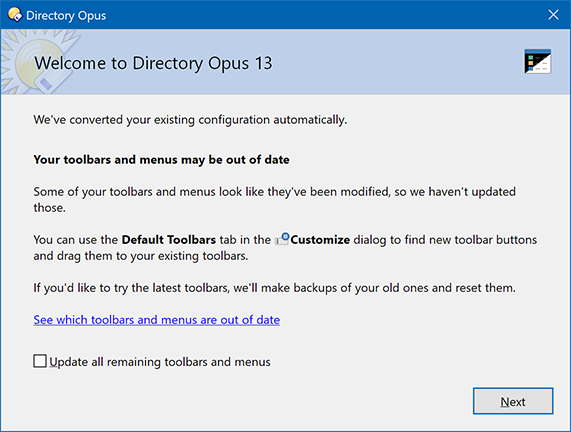

  • When upgrading, Opus asks if you want to update (factory-reset) any modified toolbars, or leave them.
  • Toolbars and Menus reset during the upgrade process will be backed up first. Backups can be found in the Customize dialog.
  • Important toolbar changes are highlighted below, but there are many more small changes.
  • A complete list of toolbar changes is here in the Detailed Release Notes: Default Toolbars & Menus

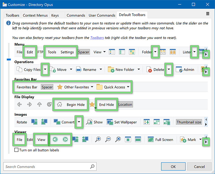

Default Toolbars

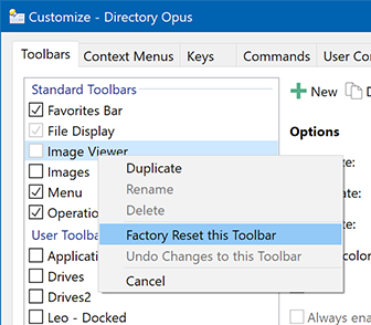

  • Items in the Standard Toolbars category, and everything on the Context Menus tab, can be factory-reset via their right-click menu. (This won't create a backup. That's up to you!)
  • If you don't want to reset the whole toolbar, the best way to find and add new commands is the Customize window's Default Toolbars tab.
  • Use the slider on the left of the tab to highlight new items in Directory Opus 13, and drag anything you want to your toolbars.

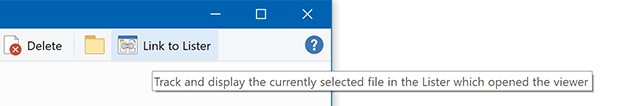

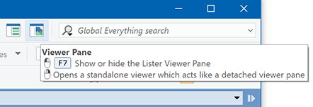

  • Lister-Linked Viewers - On the "Menu" toolbar, the button to toggle the viewer pane now has a right-click action which opens a Lister-Linked Viewer.
  • Lister-Linked Viewers - On the "Image Viewer" toolbar, there's a new button to toggle linking. (Also new buttons to move full-screen viewers between monitors.)
  • Viewer GPS Locate - On the "Image Viewer" toolbar, File menu, there's a new sub-menu to locate images. (You'll also get this on file right-click menus if you reset the Images file type group. See See File Type Groups, above.)

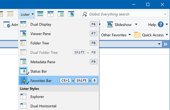

  • Favorites Bar - On the "Menu" toolbar, "Lister" sub-menu, is an option to toggle the new Favorites Bar.
  • Favorites Bar - On the "File Display" toolbar, the old Favorites menu is modified to hide automatically when the Favorites Bar is on, and reappear when it's off.

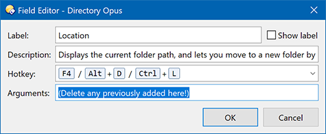

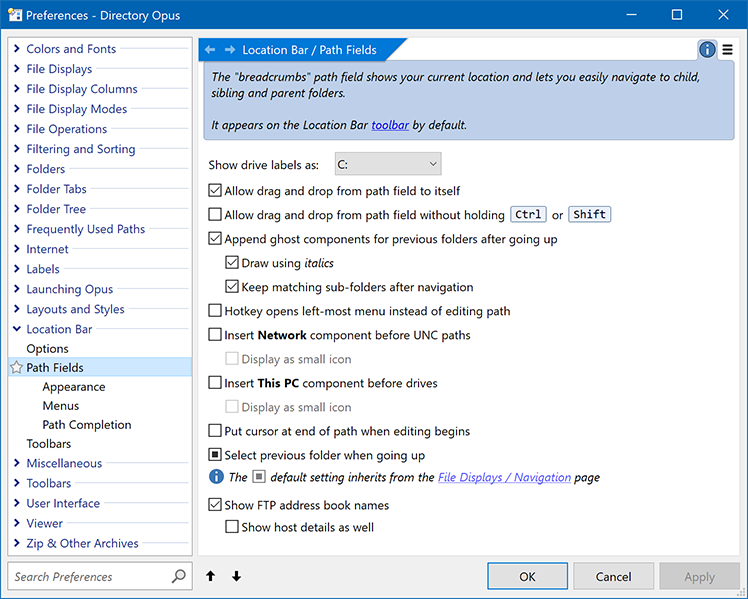

  • Path Fields (Location Bars) - Preferences / Location Bar / Path Fields has friendly options for things you used to have to configure via the "args" text field.
  • Path Fields (Location Bars) - The "args" text field can still override Preferences. If you have edited it, you might want to edit your path field(s) to clear it.

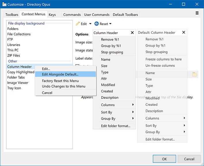

  • Context Menus, for things like right-clicking folder tabs or the file display background, have their own tab in the Customize window.
  • (File context menus are covered separately. See File Type Groups, above.)

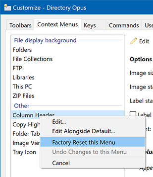

  • You can reset a whole context menu similar to how you would reset a toolbar. (Don't forget to backup first!)
  • To selectively update a context menu instead, right-click it and choose "Edit alongside default".
    • Your menu and the default menu will be displayed side-by-side.
    • Drag across elements across to add them to your toolbar without having to reset the whole thing.
  • Column Freezing - Reset or update the "Column Header" context menu if this new functionality is missing.

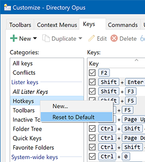

Default Hotkeys

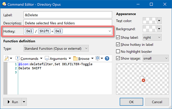

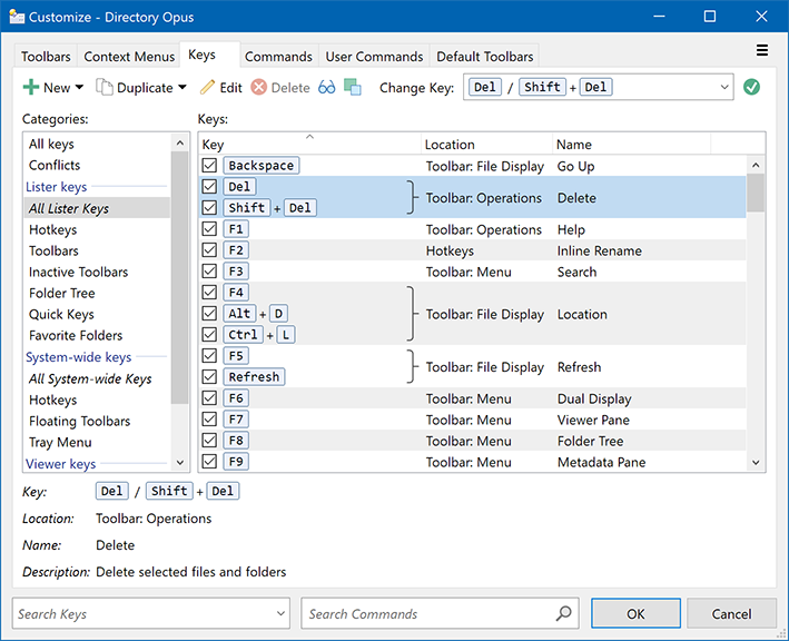

  • Several hotkeys which were standalone before are now defined within the default toolbars instead.
  • For example, the Del and Shift + Del hotkeys now both come from the Delete button on the Operations toolbar.
  • When importing an existing configuration, Opus will leave your old standalone hotkeys there unless it resets the corresponding toolbars.
  • The aim is to ensure the hotkeys still exist, in one place or the other, without losing them or creating duplicates.
  • Normally, you don't need to do anything here, but you can run into complications if you switch toolbars after upgrading.
  • Where appropriate, hotkey categories can be factory-reset via the right-click menu shown below. (Make a config backup first!)

Backup!
Remember to use Settings > Backup & Restore regularly to save a copy of your configuration!
