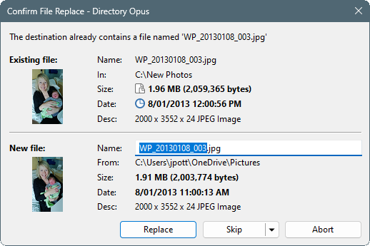

When copying files around, you'll often encounter the case where the file you're copying already exists in the target folder. In this case Opus normally displays the Confirm File Replace dialog, asking you what to do.
The goal of this dialog is to show you enough information about the existing file (the one that already exists in the target folder) and the new file (the one you are copying) to help you decide what action to take.
Basic information
The basic information that's presented for the two files is Name, Location, Size, Date (the last modified date) and Desc (the file's description). When this information is different between the two files it is displayed in bold, making it easier to see at a glance how the two files differ (except for the locations, since they are almost always different and highlighting them would make the more important differences harder to notice). The dialog also uses two little icons to indicate which file is larger and which is newer.

If possible, a description of the two files will also be shown (e.g. image dimensions). Depending on your configuration this may not be shown automatically for some folders (e.g. network paths). If information is not loaded automatically a link will be shown that you can click to load it manually. In that case you can also press F10 to load all unloaded information.
Thumbnails
If possible, thumbnail images are also displayed for the two files - if not, the file's icon will be displayed. The thumbnails (or icons) have some additional functionality:
  • If a thumbnail is displayed for the file, hovering the mouse over the top of it will display a larger preview image.
  • You can right-click the thumbnail or icon to display the context menu for the file.
  • You can double-click the thumbnail or icon to open the file.
The context menu displayed when right-clicking a file's thumbnail (or icon) can be customized using the File Types system. For example, you could add a command to compare the two files using an external comparison tool.
