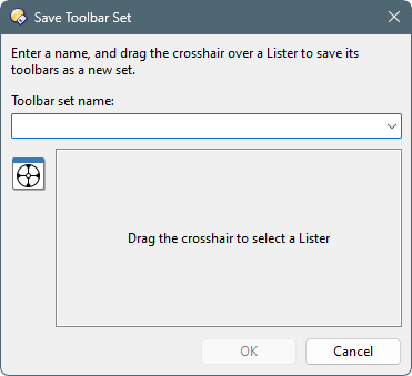

Creating a new set
Toolbar sets are created using the toolbars in an existing Lister as a template. To add a new toolbar set, first pick a Lister and open or close the appropriate toolbars. Then click the New button on this page. The following dialog will open:
To create the set, enter a name for it, and then click on the crosshair icon and drag it out of the dialog and over the Lister whose current toolbars you want to save into the set. You can also create a set from the Lister itself by right-clicking a toolbar and choosing the Toolbar Sets / Save Toolbar Set command from the context menu.
