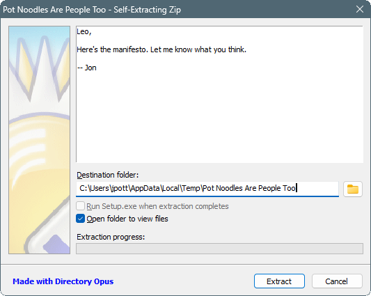

When someone runs your self-extracting archive, they will see a window similar to this:
From this window you can deduce the parameters we set when creating the extractor:
The image on the left of the window is the default - we didn't specify anything for Custom image when creating the self-extractor.
The displayed text is the result of specifying a Custom instructions file.
We didn't specify a Default path for extraction, so the default behavior is to extract to the temporary folder.
We also didn't specify an Auto-run after extraction file, so that option is disabled.
The Open folder to view files option is user-controllable; if they select that then a window (from their default folder browser) will be opened automatically to show the contents of the extracted archive.
