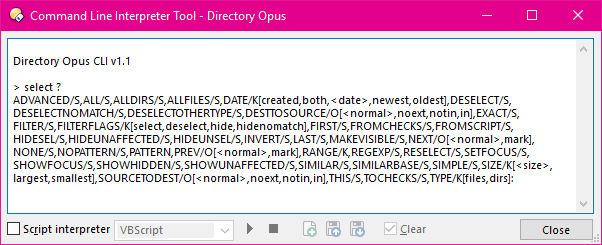

The CLI / Ad-Hoc Script Editor has two main functions:
You can open the CLI using the Tools / Opus CLI menu command.
The command line lets you run internal commands directly without having to configure a button or hotkey first. It is similar to using the find-as-you-type field in command mode. You can also display the full template for any internal command by entering the command name followed by a ? symbol (as in the screenshot above).

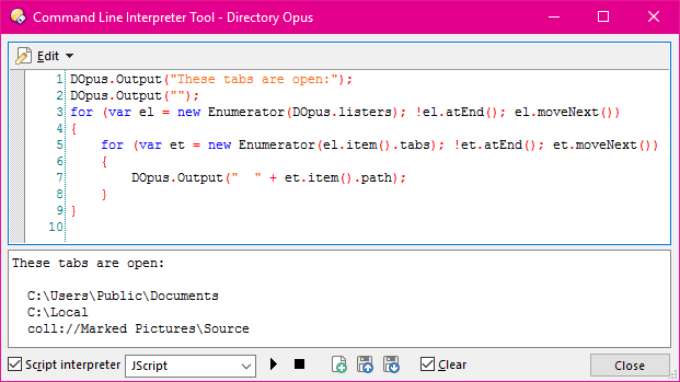

Turning on the Script interpreter option puts the CLI in Script mode, which allows you to design and test ad-hoc scripts. The drop-down field lets you select the script language - if the language you wish to use isn't listed, simply type the name in. You will need to consult the documentation for third-party languages as to the name of the "script engine". The drop-down also includes an Evaluator option which lets you test code for Opus's built-in Evaluator language.
Press F5 or click the Run button to run your script. Any errors, warnings or text output from the script (e.g. via the DOpus.Output method) will be displayed in output field below the editor.
